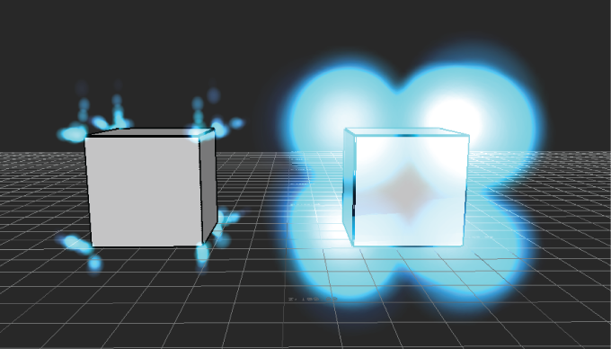

  2. In the shader’s Particle Physics pane, drag in or type a value in the Quantity field to increase the amount of particles emitted by the shader.
  3. To increase the size of each particle, go to the Size slider in the shader’s Particle Physics pane. and move the slider to the right.
    Use the Size slider to affect the size of the particles used by the shader.

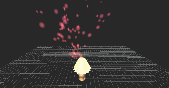

  8. Use the Life Time settings in the Particle Physics pane to determine how long a particle lasts before changing color and then fading out.
    The Life Time setting affects how long a particle lasts.
