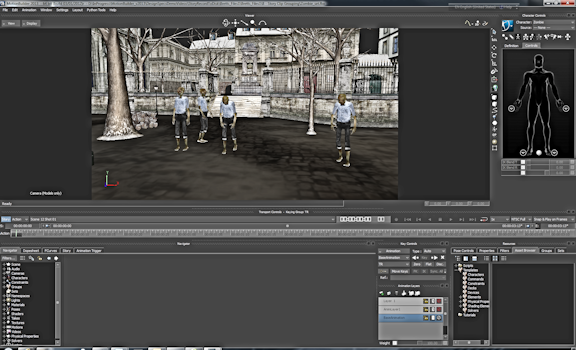

MotionBuilder includes the Editing, Scripting, and Preview layouts that are designed for specific tasks. For example, the Editing layout, with a large Viewer and numerous animation editing tools, is ideal for creating and playing back animation.
Unlike the Scripting layout, the Preview layout, and the custom layout, the Editing layout remains consistent regardless of your screen's resolution, thus providing a uniform layout experience on all systems.
Editing Layout

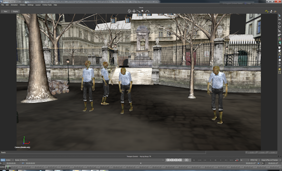

The Preview layout is the suggested layout for playing back animation as it has a screen-wide Viewer and timeline.
Preview layout

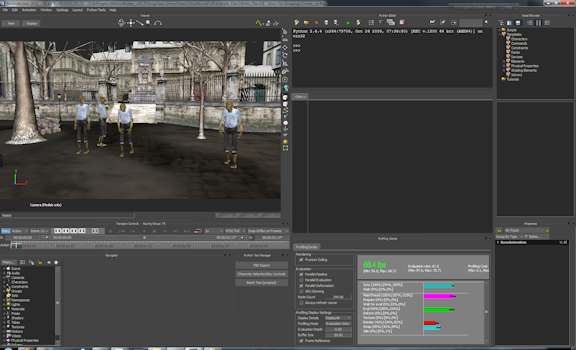

The Scripting layout contains tools that lend themselves to editing Python scripts such as the Python Editor, Python Tool Manager, Navigator, Profiling Center, and Asset Browser.
Scripting layout
