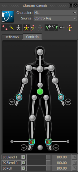

In the Character Controls toolbar (
), click the Full Body keying mode (
).In the Full Body keying mode, pasted poses are placed onto the character’s entire body, and keyframes are placed on all effectors.
In the Character Controls window, click the plus sign (+) next to each ankle effector (
) to access the auxiliary pivots.
Mia's ankles are pinned in Translation (T) and Rotation (R).
In the Character Controls window, Ctrl-click to select the wrist and ankle effectors.
The selected effectors are displayed with a blue (
) contour.In the Character Controls toolbar, disable the Pin in Translation (
) and Pin in Rotation (
) options.Note:You may have to toggle R (Rotation pinning) on and off once more to ensure that rotation is disabled.
The pinning is disabled for all four effectors as shown in the Character Controls window.

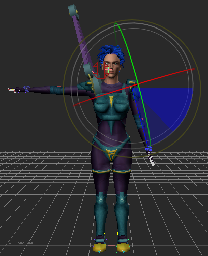

In the Character Controls window, select the Left Shoulder effector.
In the Viewer window toolbar, click the Rotate tool (
) (or click the Viewer window and press R) and rotate the effector until Mia’s left arm is in a more natural position at her side.
Do the same for the Right Shoulder effector.
- In the Character Controls window, select the Right Shoulder effector.
- In the Viewer window, rotate the effector until Mia’s right arm is in a more natural position at her side.

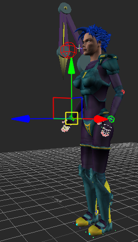

Click the Translate tool (
) (or press T) to translate both wrist effectors upward on the Y-axis to give the elbows a natural bend.
Wrists translated upward in Y-axis using the wrist effectors

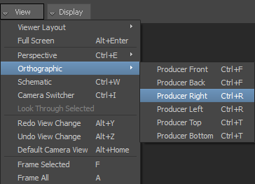

In the Viewer window, change view to Orthographic > Producer Right. In the Viewer window, click the View menu.
View menu options
Choose Orthographic
Producer Right (or click the Viewer window and press Ctrl-R).

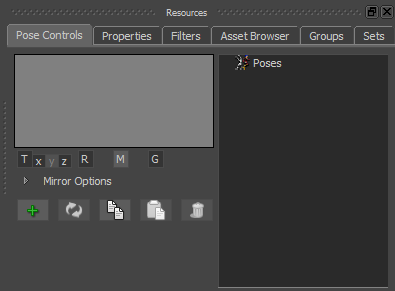

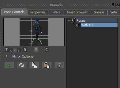

In the Resources window, click the Pose Controls tab.

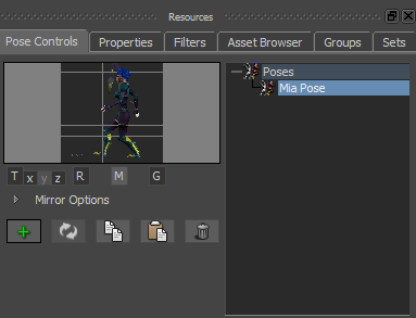

In the Pose Controls, click the Create option (
).The pose is added to the Poses group in the Pose browser.
In the Pose browser, expand Poses.
Mia Pose added to the Pose browser
The position of the Character Extension is included with the position of Mia’s body in this pose.
In the Pose browser, right-click Mia Pose.
A context menu displays.
Click Rename and name Mia Pose "Walk 01".

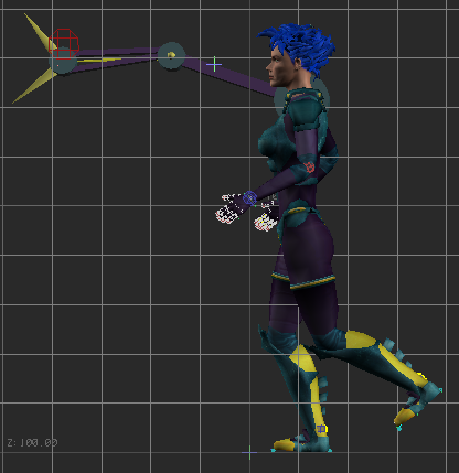

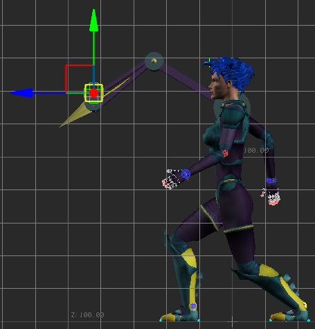

To create the second pose for the walk cycle:
Position Mia’s legs and arms so that she looks similar to the following figure.
- In the Character Controls window, select the right ankle effector, and in the Viewer window, click the Translate tool (
) and slide the right foot back and down until the foot is flat on the ground. - Select the left ankle effector, and slide the foot back until it is behind Mia, to provide momentum.
- Select the hips effector and translate in the Y-axis to bend her knees believably.
- Select the right shoulder effector, click the Rotate tool (
) and bring the right arm slightly back. - Select the left shoulder effector bring the left arm slightly forward.

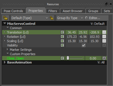

Translate the Servo Control effector in front of Mia as shown in the following figure.
Open the pincers of the Servo arm about half-way.
In the Resources window, click the Properties tab.
The Mia:ServoControl effector properties are displayed.
Under the ServoControl properties, drag the slider of the Close_Open property about half-way.
In the Viewer window double-click in an empty area to deselect the Translate mode.

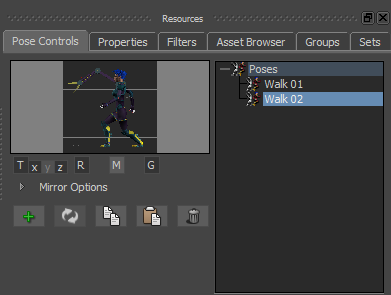

Create a pose and name the pose “Walk 02”.
Name this new pose "Walk 02".

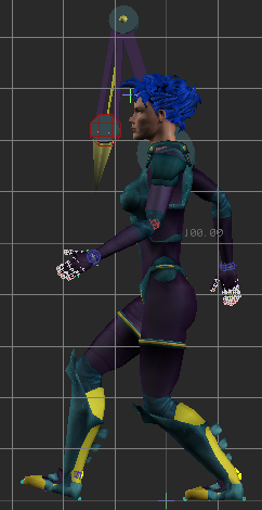

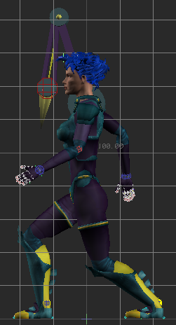

To create the third and final pose for the walk cycle:
Position Mia’s legs and arms so that her step appears similar to the following figure, extend the Servo arm further in front of Mia and open the pincers as shown.
In this pose, the left leg goes back, and the Servo arm goes forward, completing one step for the first half of the walk cycle.
Double-click the Viewer window to deselect your last selection.

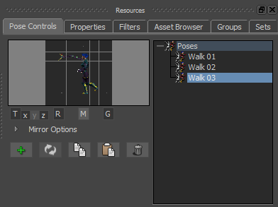

Name this pose “Walk 03”.
