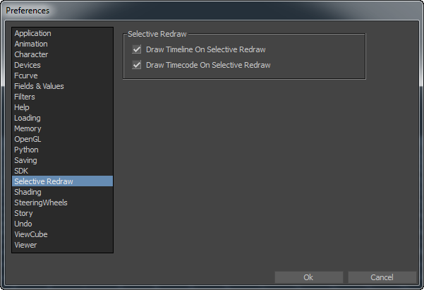

To access the Selective Redraw preferences:
From the menu bar, select Settings > Preferences.
In the Preferences window, click the Selective Redraw preference option.
The Selective Redraw preference settings display.
The Draw Timeline On Selective Redraw option lets you specify whether the Timeline is updated. Activate this option to update the timeline. Disable it to achieve faster frame rates by skipping the automatic Timeline update. This option is active by default.
The Draw Timecode On Selective Redraw option lets you specify whether the time code is redrawn. Activate this option to update the Timecode, disable it to achieve faster frame rates by skipping the automatic Timecode update. This option is active by default.
