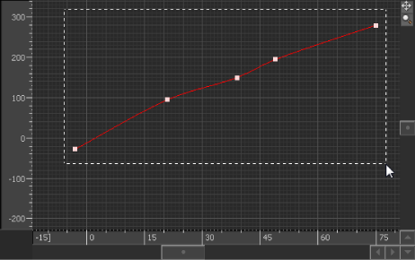

  1. Drag-select a group of keyframes on a FCurve. This illustration show keys on the x-translation curve.

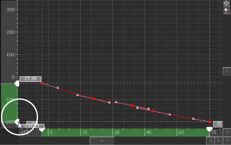

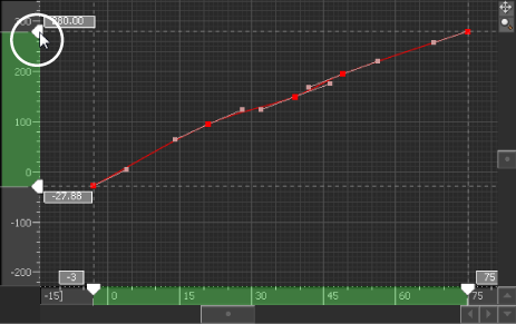

  2. Select the top white arrow.
  3. Drag the top white arrow, so that it is below the bottom white arrow. This inverts the direction travelled along the x-axis.
