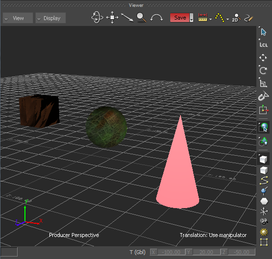

Viewer window toolbar
The Viewer window toolbar displayed by default along the right side of the Viewer window enables you to choose how you want to select, manipulate, and transform objects in the Viewer window.
Viewer window toolbar shown along the right side of the Viewer window
You can change the default location of the Viewer window toolbar via the Preferences window, under the Viewer option. See Preferences window.
