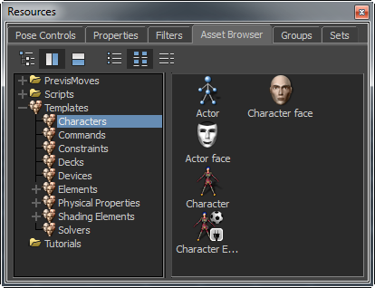

- In the Resources window, click the Asset Browser tab.
- In the Asset Browser, select an asset type to display the available assets. For example, when you select Character, character assets display as icons in the area beside the asset list.
Asset Browser: Character assets
- Drag-and-drop an asset's icon onto the Viewer window to add the asset to the scene.
