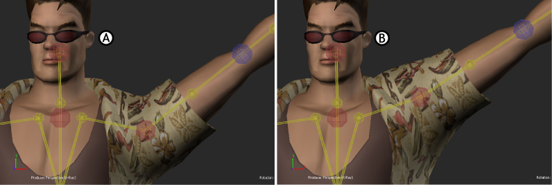

Realistic Shoulder Solving
When human shoulders rotate, they move upwards. To replicate this behavior, use this setting to adjust the amount of rotation that is applied to the shoulders when the upper arms rotate.
For example, in the following figure (A), displays a character when its upper arm is rotated with Realistic Shoulder Solving set to 0 (disabled). When the upper arm rotates, the rotation is not properly transferred to the shoulder bone, resulting in poor movement.
In the following figure (B), the upper arm in the character is rotated with Realistic Shoulder Solving set to 100 (full). When the upper arm rotates, 100 percent of the rotation is transferred to the shoulders. Since the shoulder bones rotate, the shoulders of the character appear to translate upwards in the same manner as human shoulders.
Upper arm rotated A. Realistic Shoulder Solving disabled (set to zero) B. Realistic Shoulder Solving set to full (100)
By default, Realistic Shoulder Solving is set to 0.

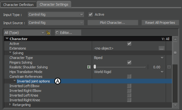

Constrain References
Turn on this option if you are working with a project created in a previous version of MotionBuilder. Turning on this option constrains the Control rig reference object to the character Reference object.
Inverted joint options
Let you change the way the knees and elbows of a character bend as you manipulate the legs and arms.
These options are useful if you are animating a bird, such as a flamingo or ostrich.
Character Settings A. Inverted joint options
Important:
Always turn the Inverted joint options on or off before manipulating your character.
OptionDescription
Inverted Left/Right ElbowWhen activated, the left/right elbow of the character bends backward as you manipulate the arm. When disabled, the left/right elbow of the character bends normally.
Inverted Left/Right KneeWhen activated, the left/right knee of the character bends backward as you manipulate the leg. When disabled, the left/right knee of the character bends normally.

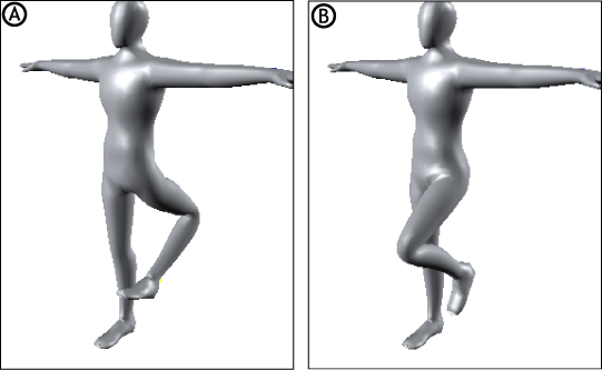

In the following figure, the left leg is manipulated with the Inverted Left Knee turned on (see A) and with the Inverted Left Knee turned off (see B).
Left leg manipulated A. Inverted Left Knee turned on B. Inverted Left Knee turned off

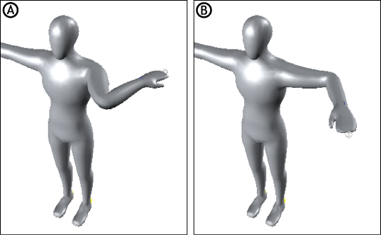

In the following figure, the left arm is manipulated with the Inverted Left Elbow turned on (see A) and with the Inverted Left Elbow turned off (see B).
Left arm manipulated A. Inverted Left Elbow turned on B. Inverted Left Elbow turned off
