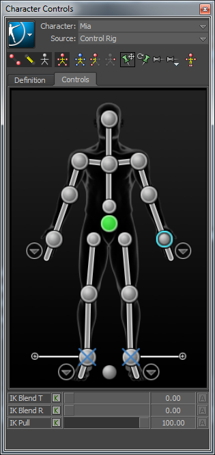

Controls tab
This tab displays the character with Control rig and HumanIK controls.
The following table provides a brief overview of tasks that you can perform using the Controls tab:
