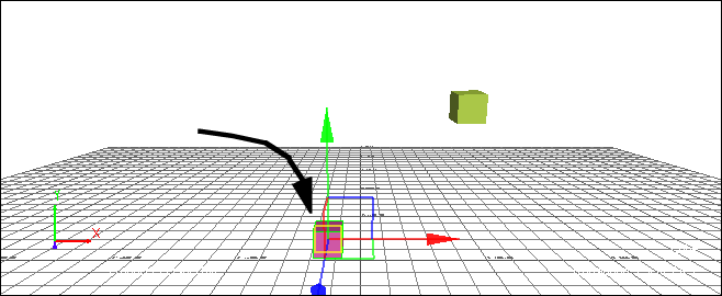

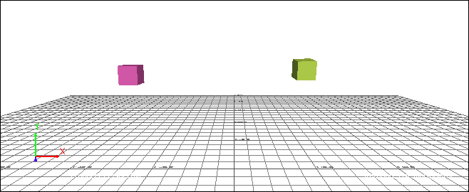

- Drag two cubes from the Elements folder of the Asset browser into the scene, positioning them similar to the cubes in the following picture.
Optional: You can change the color of the two cubes by adding a material to each, then changing the Diffuse property.

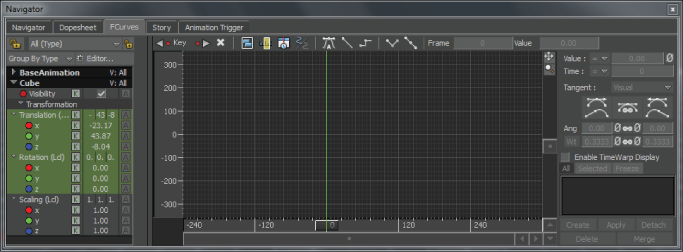

- Select the cube on the left, then open the FCurves window if it is not already open in the current layout.
FCurves window
The properties of the selected cube display in the FCurves properties pane as well as in the Properties window.

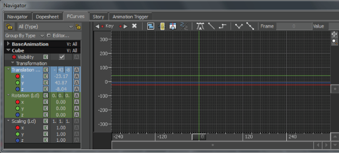

- In the FCurves window Properties pane, click the Translation (Lcl) header to select the cube’s Translation properties.
Cube’s Translation properties selected, showing the function curves
The cube’s translation properties are selected and their representative function curves display. Right now, the function curves are flat because the cube is not yet animated.
The color of the function curves correspond with the color of the axis they represent. By default, the function curve for the X-axis is red, the Y-axis is green, and the Z-axis is blue.

Do one of the following to translate the selected cube higher and to the right:
- Click in the Viewer window and press T to activate Translation mode, then translate the selected cube upward on the Y-axis.
- In the FCurves window, drag in the value fields next to a property in the Properties pane.
- Translate the first cube higher and to the right.

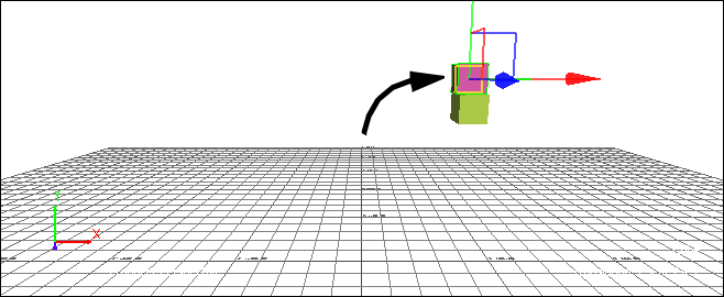

- Go to frame 30 and translate the first cube until it sits on top of the second as shown in the following figure, then set another keyframe.

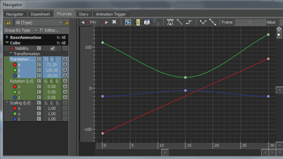

- Click in the FCurves pane, then press A to frame the function curves.
Function curves framed
Drag around the three keyframes on frame zero to select them.
Tangent handles display on the selected keyframes, and their coordinates display in boxes on the horizontal (time) and vertical (value) axes.
