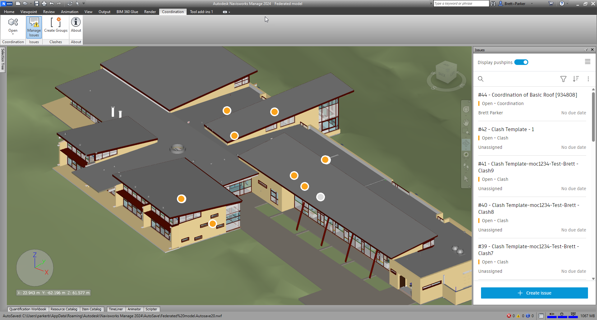

Click the Coordination tab > Issues panel > Manage Issues to open the Issues panel.
Issues are displayed on the model as pushpins, and listed in the panel.
Tip: From the drop-down menu, click Refresh in the panel to load any changes to issue data, and sync between BIM 360 or Autodesk Docs, and Navisworks.
Model courtesy of DesignGroup and the National Audubon SocietyTo apply a filter to display a subset of issues, click Filter, select one or more filter criteria, and then click Apply.
Tip: You can filter issues by type, status, location, owner, assignee, due date, root cause, issue creator, and creation date, and any custom attribute filters that have been set up.To sort how the list of issues is ordered, click Sort.
Tip: You can sort issues by status (Open to Closed, or Closed to Open), ID (ascending or descending), and due date (old to new, or new to old).Select or search for an issue on the panel, or click a pushpin on the model.
The view orientates to the issue on the model, and the panel displays issue details and the activity log.

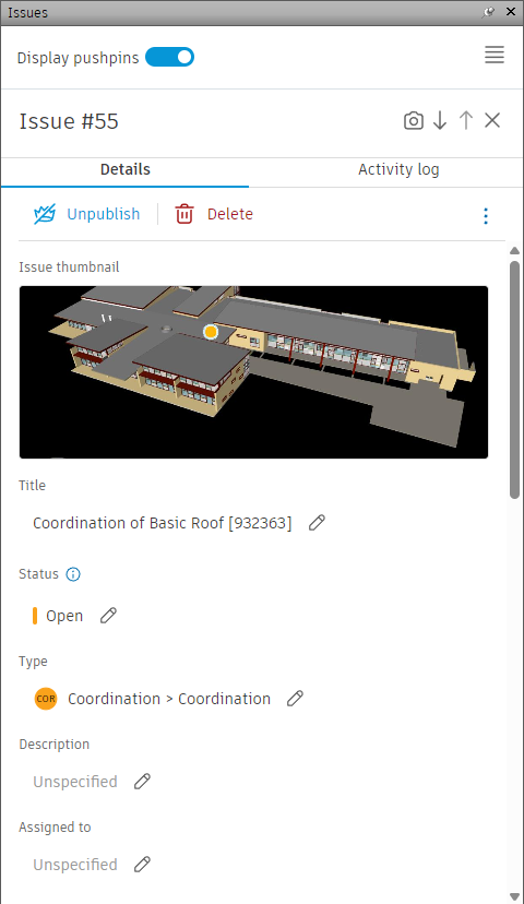

Respond to or Edit Issues
In the Issues panel, open an issue as described above.
Note: Only issue creators, owners, and BIM 360 or Autodesk Docs project administrators can set an issue to Closed. Use @ to mention a project member in a comment.Use the Details, Attachments, and Activity log tabs to review the issue details, view any attached files or photos, and see the recent activity on the issue.
to sync the issue edits between Navisworks, and BIM 360 or Autodesk Docs.Close the issue to return to the issue list.
can be used to navigate between issues without the need to close individual issues. The issue camera icon
can be used to take and append new images to issues without the need to screenshot, save, and upload to issues manually.Create Issues

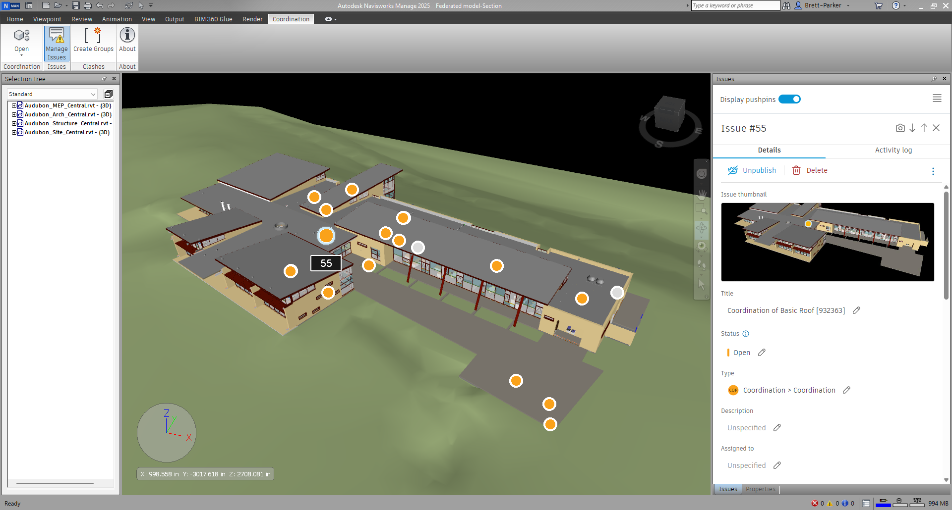

In the Issues panel, click Create issue.
Click on the model to place the issue pushpin and create the issue.
The new issue is displayed in the panel:
Model courtesy of DesignGroup and the National Audubon SocietyUse the Details tab to edit the issue details. The fields displayed depend on the issue type selected.
Tip: By default, the Title is prefilled based on the model element selected, but can be edited.From the drop-down menu, click Refresh
to sync the new issue between Navisworks and BIM 360 or Autodesk Docs.

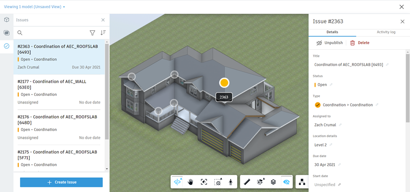

The new issue can be viewed and edited in Model Coordination:
Any changes made in Model Coordination will be reflected back in Navisworks.

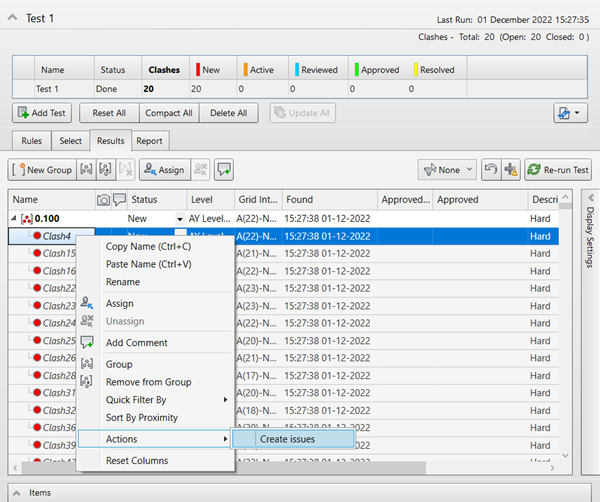

In the Clash Detective window > Results tab, select the clashes you want to create issues from. You can select a single clash or clash group, or use Ctrl + click to select multiple clashes and create an issue for each.
Right-click on your clash selection to display the context menu, and then select Actions > Create issues.
