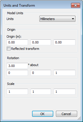

Change a transform in a 3D model
  1. Right-click the desired 3D model in the Selection Tree.
  2. Click Units and Transform on the context menu to open the Units and Transforms dialog box.
  3. Use the Origin area to change the model’s location:
    • Enter values for the X, Y and Z axis.
    • If you use a negative scale, select the Reflected Transform check box.
  4. Use the Rotation area to change the model’s rotation:
    • Enter an angle of rotation.
    • Select the axis to rotate about (by typing a value greater than 0). This will rotate the model about its origin point.
  5. Use the Scale area to change the model’s scale:
    • To proportionally scale an object, ensure the X, Y, and Z values are equal.
    • Enter a negative value to flip the model inside out.
  1. Click OK.
