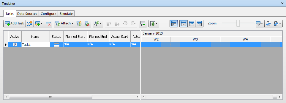

Add Tasks Manually
Load your model into Navisworks (see Open Files if you need help).
Click Home tab > Tools panel > TimeLiner
, and click the Tasks tab in the TimeLiner window.
Click Add Task
or right-click anywhere in the task view, and click Add Task on the context menu.
Note: You can click on an existing task and select Insert Taskto insert a task above the selected task.
Enter the name for your task, and press Enter. The task is now added to your schedule.
Note: If you press Enter when the bottom task in the task view is selected, then a new task will be created below it.
