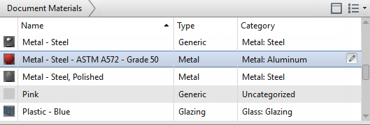

Document Materials Panel
Displays the materials saved with the open file.

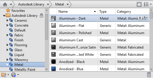

Library Panel
Lists the categories in the materials libraries that are currently available. The materials in the selected category are displayed on the right. The buttons for applying or editing the material become available when you hover the mouse over the material swatch.
You can apply materials to model objects by dragging material swatches from the Library panel to objects in the Scene View. You can also drag swatches to the Document Materials panel to save with the open file.

Library (Library panel only)
Displays the library you specify
  • Favorites - A special user library which stores the collection of user-defined materials. This library cannot be renamed.
  • Custom libraries - Custom libraries that you create or import into the current drawing.
