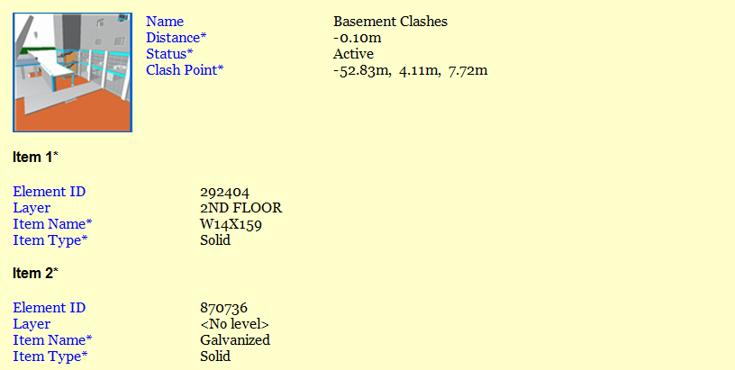

- Group Headers Only - your report will include summaries of clash groups and individual clashes not in groups.
An example of an HTML report with group headers only

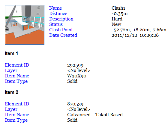

- Individual Clashes Only - your report will only contain individual clash results, and will not distinguish those results that have been grouped. For each clash that belongs to a group, an extra field, called Clash Group, can be added to the report to identify it. To enable this functionality, select the Clash Group check box in the Contents area.
An example of an HTML report with individual clashes only

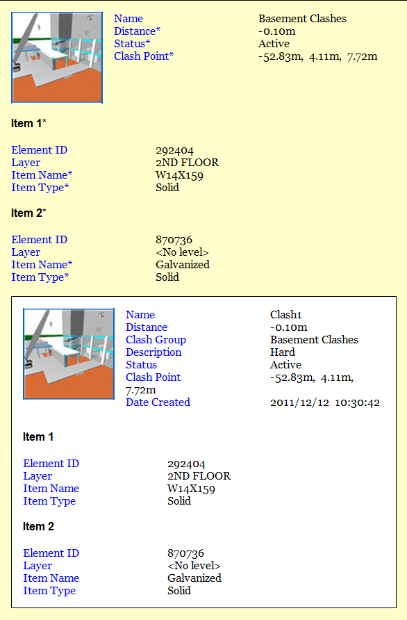

- Everything - your report will contain summaries of clash groups that you have created, clash results that are part of each group, and individual clash results. For each clash that belongs to a group, an extra field, called Clash Group, can be added to the report to identify it. To enable this functionality, select the Clash Group check box in the Contents area.
An example of an HTML report with both group headers and individual clashes
