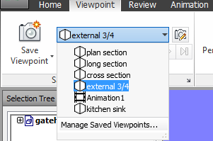

Erase Markups
Click Viewpoint tab > Save, Load & Playback panel > Saved Viewpoints drop-down, and choose the viewpoint that you want to review.
Click Review tab > Markup panel > Draw drop-down, and click Erase
.Drag a box over the markup you want to delete, and release the mouse.
