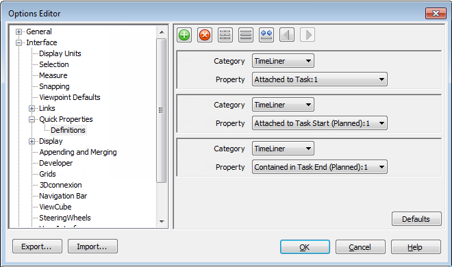

  1. Click the application button > Options.
  2. In the Options Editor > Interface node > Quick Properties option, click Definitions.
  3. Select TimeLiner in the Category box.
  4. Select Attach to Task: 1 in the Property box.
  5. Add several more definitions with TimeLiner selected in the Category box, and the desired properties in the Property box.
  6. Click OK to save the changes.
    When you now select the Quick Properties check box in the Contents area on the Report tab of the Clash Detective window, your report will include the additional data you’ve specified here.
