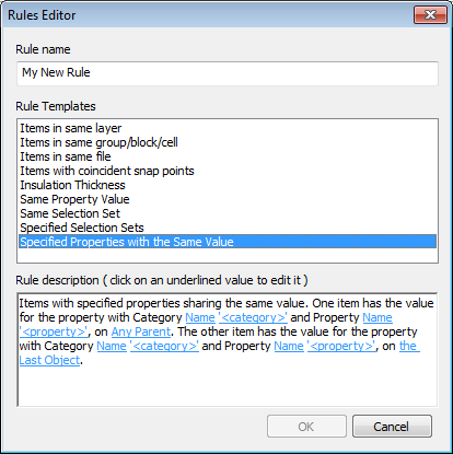

Click Home tab > Tools panel > Clash Detective
.On the Rules tab, click New.
In the Rules Editor dialog box, enter a new name for your rule.
In the Rule Templates list, click the template you want to use.
In the Rule Description box, click each of the underlined values to define your custom rule. The customizable values available with the built-in templates are:
