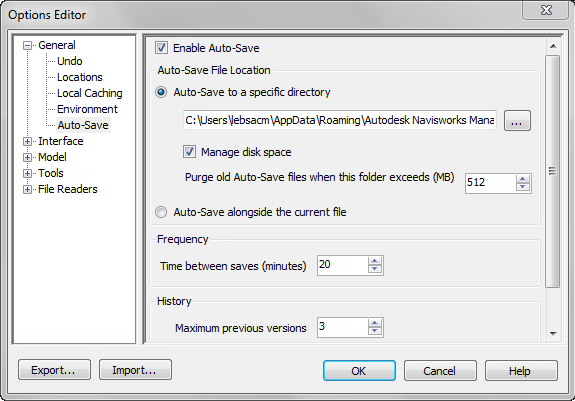

Customize the Auto-Save Options
  1. Click the application button and then click Options.
  2. In the Options Editor, expand the General node and click Auto-Save.
  3. Adjust the Auto-Save options, as required. For example, if you want Navisworks to save a backup file every 20 minutes from a significant file change, enter 20 into the Time between saves (minutes) field.
  4. Click OK.
See the Auto-Save Page topic for more information on these auto-save options.
