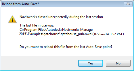

In the event that Navisworks closes before you save changes to your file, you can either automatically reload the last file you were working on, or manually load a backup file.
Note: The ability to load a backup file depends on your auto-save settings.
  1. Open Navisworks.
  2. To open the most recent saved version of the file you were working on, click Yes on the automatic prompt:
  3. To manually load a backup file, Click No on the prompt, and then click the application button > Open > Open .

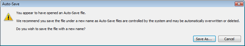

  7. When you are prompted to save the file with a different name, click Save As.
  8. In the Save As dialog box, enter a new file name, and browse to the desired save location.
  9. Click Save.
