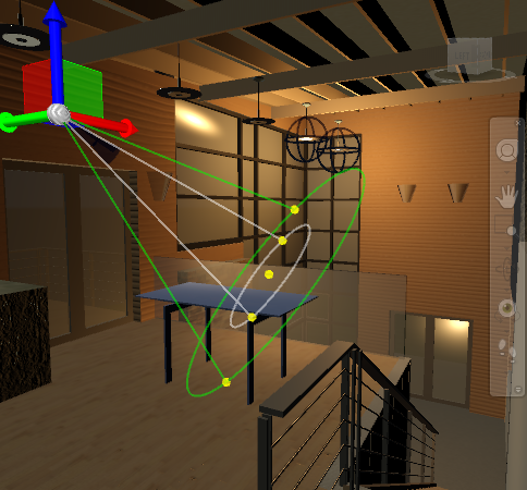

Lighting enhances the clarity and three-dimensionality of a scene. You can create point lights, spot lights, web lights, and distant lights to achieve the effects you want. You can move or rotate them with gizmos, turn them on and off, and change properties such as color and intensity. The effects of changes are visible in the Scene View in real time.
Lights (point, spot, distant, and web) are each represented by a different light glyph (a symbol in the model showing the location of the light). The sun is not represented by a light glyph because it does not have a discrete position and affects the entire scene. You can turn the display of light glyphs on or off while you work.
