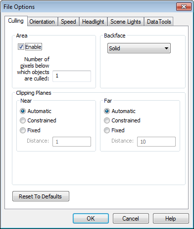

File Options
For each Navisworks file (NWF and NWD), you can adjust the model appearance and the speed of navigation around it. Viewing options are stored with Navisworks files (NWF or NWD), and reloaded each time you open these files.
