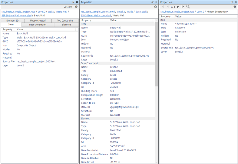

Enhanced Properties Panel
The existing properties panel was overdue a redesign and in need for many requested features. As such we are introducing the new enhanced properties panel into product for Navisworks 2025.
There are many improvements to the properties panel allowing for additional functionality such as:
- Stacked category tabs
- Combined category / single list
- Favorites
- Multiple selection traversal
- Auto zoom to selected
- Hyperlink support
- Column sorting
- Category sorting
- Find matching items
- Create search
- Add to existing search
