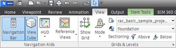

Section Above And/Or Below Grid
This new feature adds the ability to create section planes to the top and bottom heights of a grid levels. It is currently possible to fit selection when creating sections, but with these new buttons, you can fit to grid above and/or below.
To use this feature, the mode must be set to Fixed then select an Active Grid and Display Level and finally click Above and/or Below to section to the selected level.
