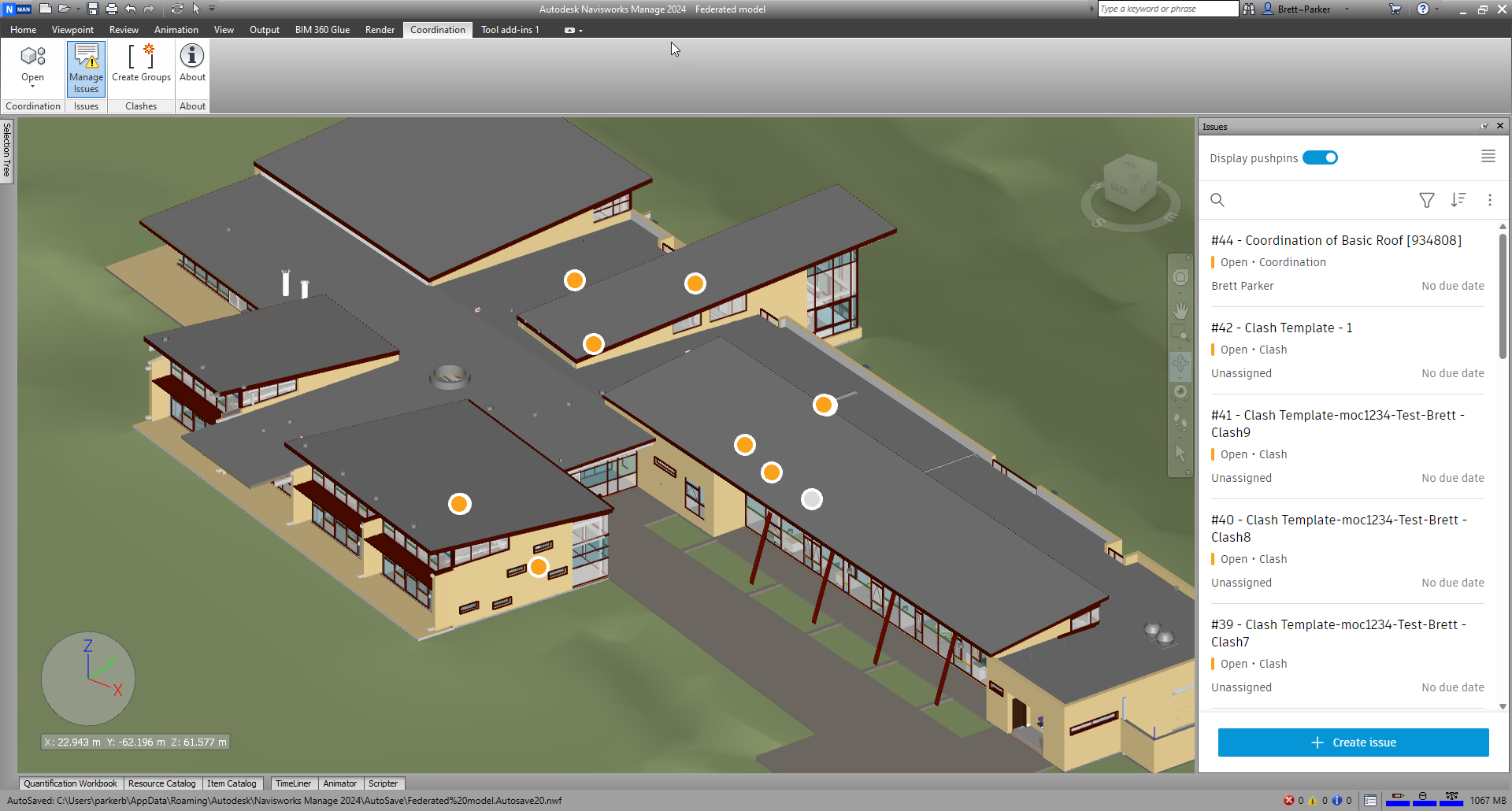

  1. Click the Coordination tab > Issues panel > Manage Issues to open the Issues panel.
    Issues are displayed on the model as pushpins, and listed in the panel.
    Tip: From the drop-down menu, click Refresh in the panel to load any changes to issue data, and sync between BIM 360 or Autodesk Docs, and Navisworks.

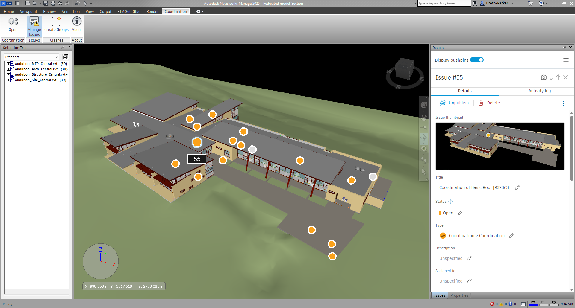

  1. Open the model you want to create an issue for.
  2. In the Issues panel, click Create issue.
  3. Click on the model to place the issue pushpin and create the issue.
    The new issue is displayed in the panel:
    Model courtesy of DesignGroup and the National Audubon Society

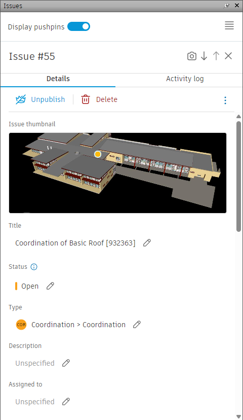

  4. Use the Details tab to edit the issue details. The fields displayed depend on the issue type selected.
    Tip: By default, the Title is prefilled based on the model element selected, but can be edited.

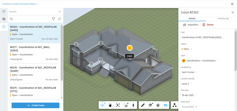

    The new issue can be viewed and edited in Model Coordination:
    Any changes made in Model Coordination will be reflected back in Navisworks.

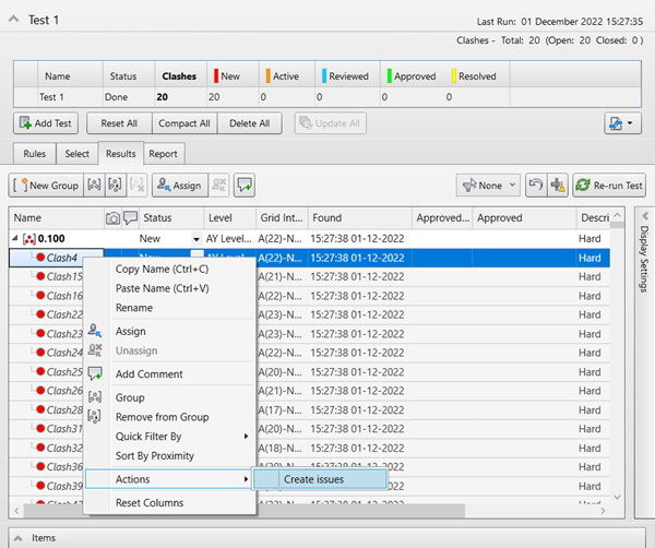

  4. In the Clash Detective window > Results tab, select the clashes you want to create issues from. You can select a single clash or clash group, or use Ctrl + click to select multiple clashes and create an issue for each.
  5. Right-click on your clash selection to display the context menu, and then select Actions > Create issues.
    Tip: If an issue has already been created for a clash result, you can use the right-click > Actions > Select issues option to select the related issue.
