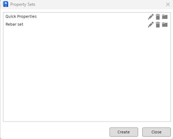

Click the Home tab > Display panel > Property Sets option.

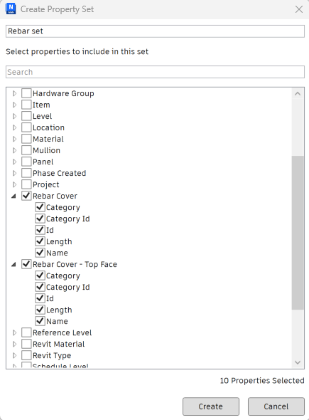

On the Property Sets dialog box, click Create.
On the Create Property Set dialog box, enter a name for the quick property.
Use the Search field to search for specific properties, or navigate the properties in the tree.
Select the check boxes next to the properties that you want to include, and then click Create.
The created set will appear in the Property Sets drop-down list in the Properties window, enabling you to quickly filter the properties. Property sets also appear in the Selection Inspector window.
