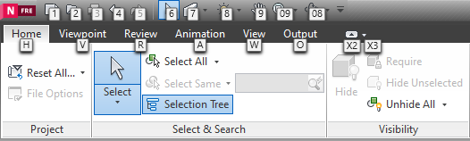

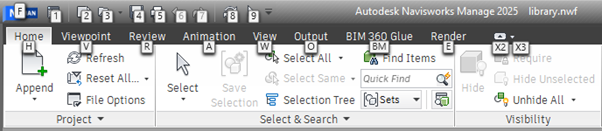

Navisworks provides accelerator keys, or keytips, to enable you to use the keyboard, rather than the mouse, to interact with the application window.
Keytips are provided for the application menu, Quick Access toolbar, and ribbon. You can still use ‘old style’ keyboard shortcuts, such as CTRL + N to open a new file, and CTRL + P to print the current file.
To Display Keytips
Press ALT.
Note: The keytips (letters or numbers) are shown on the screen next to the corresponding command or user interface element.Press the displayed accelerator key to immediately invoke the desired command or to show the user interface element.
For example, pressing ALT, and then pressing 1 creates a new file.
Navisworks Navisworks Freedom
To hide the keytips, press ALT again.
