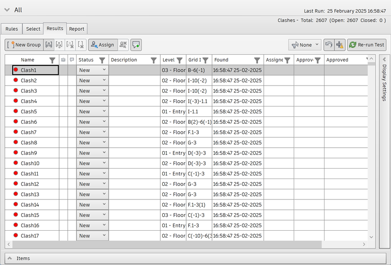

All found clashes are shown in the Results tab in a multi-column table. You can click on any of the column headings to sort the table using that column's data. This sorting can be alphabetical, numerical, date-related, or, for the Status column, in workflow order: New, Active, Reviewed, Approved, and Resolved.
If you run a time-based, soft, or time-based soft clash test, the start time/date of any clashes are recorded next to the appropriate clash under the Start and End columns, together with the event name (an animation scene or a TimeLiner task) in the Event column. If multiple clashes are found on a particular date, each individual clash is listed with identical simulation information. If your model contains a grid system then grid levels and intersections are also displayed.
