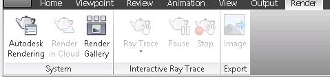

The Autodesk Rendering tools can be accessed from both the Home tab > Tools panel and the Render tab on the ribbon.

The real-time model navigation is supported for the realistic visual style (controlled with the tools on the Viewpoint tab > Render Style panel), and for the photorealistic visual style (controlled with the Ray Trace
button on the Render tab > Render panel).
