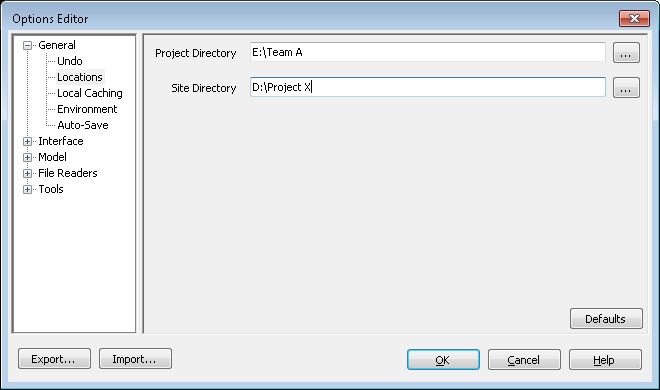

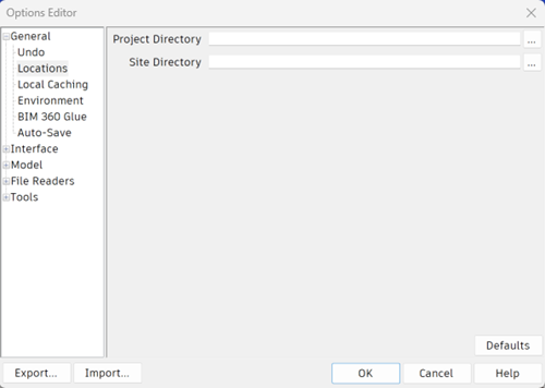

Configure Location Options
Click the application button
> Options.Expand the General node in the Options Editor, and click the Locations option.
In the Project Directory box, browse to the directory that contains the Navisworks settings specific to your project group.
In the Site Directory box, browse to the directory that contains the Navisworks settings standard across the entire project site.
Click OK.
Note: When you run Navisworks for the first time, the settings are picked up from the installation directory. Subsequently, Navisworks examines the current user profile and the all users profile on the local machine, and then checks the settings in the Project Directory and the Site Directory. The files in the Project Directory take precedence.
