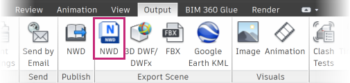

Export to NWD
You can now configure and export NWD files out of Navisworks using the new Output tab > Export Scene panel > Export NWD option.
The available configuration options are:
  • Exclude hidden items - Removes hidden objects from the NWD on export.
  • Embed ReCap and texture data - Embeds externally referenced files, including textures and ReCap files, into the NWD on export.
  • Prevent object property export - Excludes object properties that come from native CAD packages in the exported file.
  • Navisworks Version - Specifies the file format version that you want to save the NWD file as.
