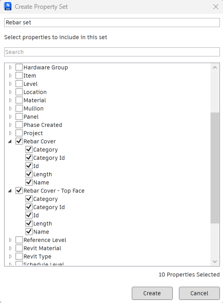

You can now easily filter for and create custom sets of properties using the new Home tab > Display panel > Property Sets option.
Create property sets by searching for properties, or navigating the property tree in the Create Property Set dialog box:
Created property sets are available in the Properties window, the new Quick Properties drop-down list on the Display tab, and also in the Selection Inspector window, enabling export as a CSV.
