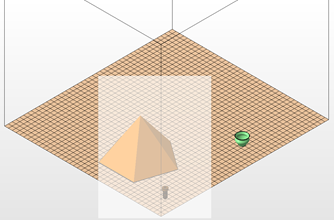

  • Window:: Click and drag a window on the display to select all parts within the window.
    Select several parts at once with help of a window selection.
