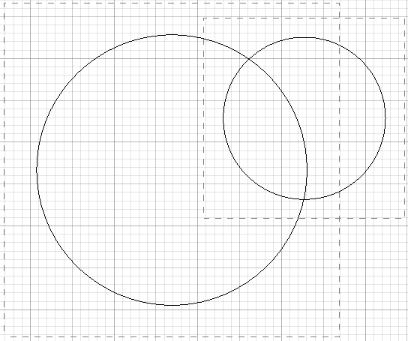

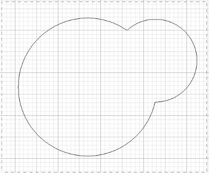

The unify filter joins one or several input slice stacks into a single slice stack according to the positive fill rule (as specified in the 3MF specification). The output consists of closed contours which are not self-intersecting. Any hatching in the input data is ignored.
If only one input slice stack is given, this operation effectively removes all self-intersection from the stack.
