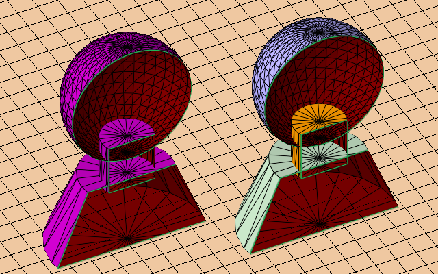

To split shells into parts
Turn the shells of a part into individual parts each
  1. Select the part containing multiple shells.
  2. Click Modify > Edit shells > Split shells into parts.
  3. Click Yes to replace the current part or click No to create a new part.
Left: A single part with three overlapping shells. Right: After splitting, each shell is now a separate part.
