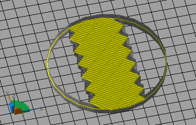

A cylinder of 100 mm diameter, with hatches clamped to ±20 mm using axisfilter. The platform grid spacing is 10 mm.
