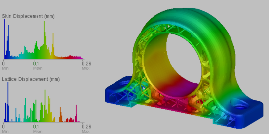

Displacement results for a lattice and skin optimization
