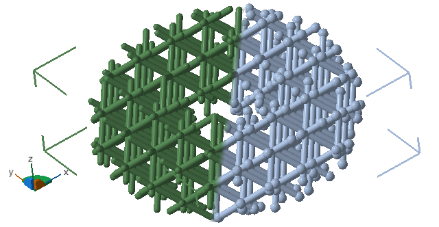

To show that you are currently editing a lattice, it is displayed in light blue, as opposed to dark green:
The light blue display color (on the right) of a lattice body indicates that its junctions and beams can be edited individually.
