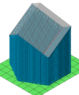

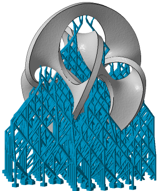

| Adaptive lattice bars
This action generates a regular volumetric scaffolding from lattice cells of interconnected bars. This makes very rigid bar support possible in areas that have undercuts themselves while minimizing part-to-part support. The bar density is also dependent on the individual support requirement: If there is enough free volume available, multiples of cells are recursively collapsed into singular larger cells. ![]() The scaffolding of bars supports otherwise difficult-to-reach surfaces well. |

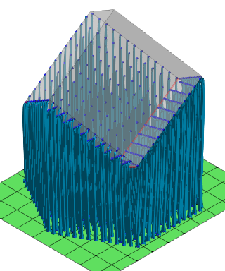

Bars on areas
![]() Critical areas of downskin receive bar supports. Bar supports may be branched into bouquets. If the area contains local points, these are supported with priority, and the regular grid of bar supports is adjusted to avoid duplicate support bars in close or same positions. |

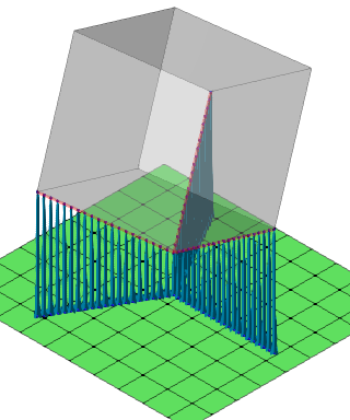

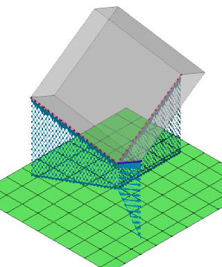

Bars on edges
![]() Down-oriented or overhanging edges are supported by tracing them with a row of bar supports each |

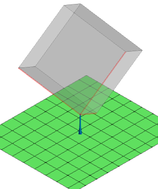

Bars on points
![]() Critical, down-oriented corner points or clusters receive bar or few bars each. |

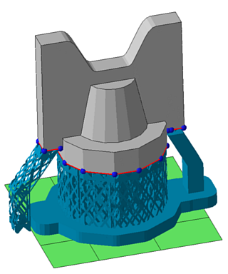

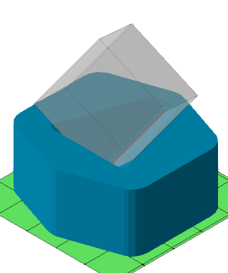

Base setter
A setter is a volume conformal to the original shape. Setters are used to keep the part in position and orientation during sintering. As such, they do not actually contact and mechanically fixate the part like other support types. ![]() The setter serves as a counterpart to the original shape. |

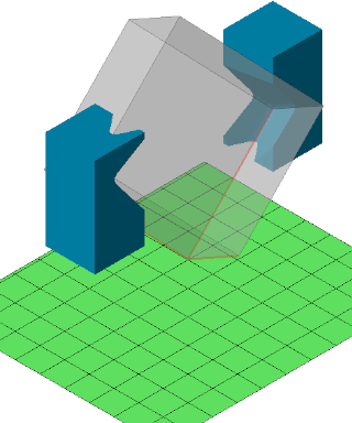

Lateral support
![]() Lateral supports are similar in function to the setter except that they follow the model shape along the periphery rather than the bottom. |

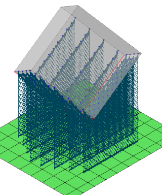

Polylines on areas
![]() Critical areas of downskin receive supports in the form of sets of straight polyline walls in parallel orientation. |
