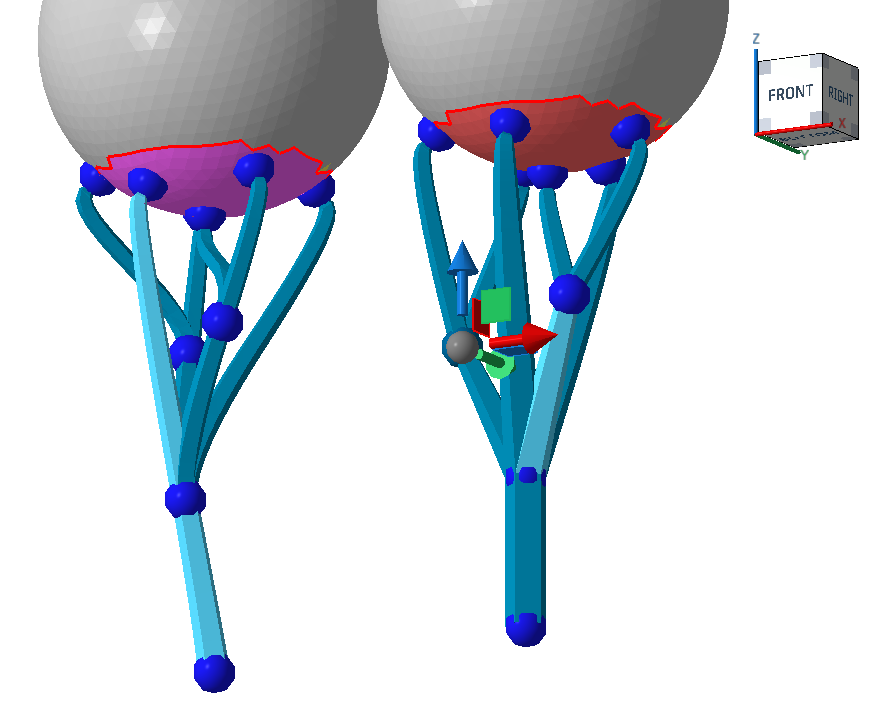

| Bouquet type |
Anchor on bar picks one main bar and grows additional bars from it or from other bars that originate on the main bar themselves ("side branching"). Free anchor uses iterative splitting of bars into ever thinner ones to ultimately cover the cluster's entire surface area with supports ("split branching"). Side branching
Split branching
![]() Side branching (left) and split branching (right). Note how the selected one on the left goes all the way from the part surface to the bottom, and how other beams "sprout" from it, whereas on the right, the branches split evenly. |

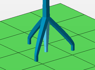

When active, the bottom of the bars are multiplied to form a tree-root-like structure that reinforces the adherence of individual bars.
| Number of legs |
![]() The count of legs includes the center one. |
