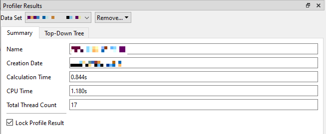

On the Summary tab activate Lock Profile Results to protect it from removal.

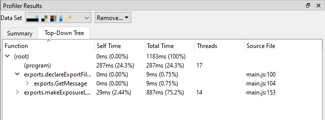

On the Top-Down Tree tab unfold nodes to drill down the function and branching hierarchy. Clicking the column headers sorts the table by that column.
