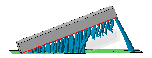

Analysis
Cluster detection controls how the downskins, made up of triangle clusters, are detected for viewing and for manual support generation.

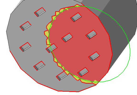

Mark cluster manually holds the settings for manually selecting triangles to be supportable clusters

Analyze
Critical angle
Triangles tilted up to this angle from the horizontal are considered to require support. Use this visual aid at your discretion to find surfaces which must receive supports. Triangles so detected are highlighted in dark red.
Non-critical angle
Triangles tilted up to this angle from the horizontal receive support if they are adjacent to enough other triangles that also require supports. This generates a smoother cluster silhouette. A smoother support silhouette makes removing supports easier. Triangles so detected are highlighted in yellow. The resulting cluster is highlighted with a bright red outline.
Minimum area
Detected areas that would receive supports but are smaller in size than this threshold do not get supported.

Brush size
Adjusts the brush size for when Mark cluster manually is active
Note: Manual marking and automatic detection cannot be combined. Also, the critical and non-critical angle for manual marking is fixed at 90°.
Edge threshold
When manually marking clusters, triangles under the brush but beyond a convex edge remain unmarked when its angle is sharper than this threshold. Also applies to flood-filling of surface patches.
The edge threshold makes marking large areas with many small perforations much easier.
