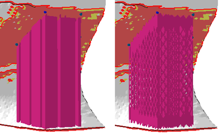

Volume supports fill shadow volumes of downskin areas: The volume formed by projecting the downskin area towards the platform is filled with volumetric support structures. By default, they are open and scaffolding-like, built from open mesh surfaces without volume, traced by single beam passes.
Left: Solid volume supports divided into fragments. Right: Volume supports built from a patterned structure.

| Filling type |
Switch the support walls between Closed volume (solid) and Structure.

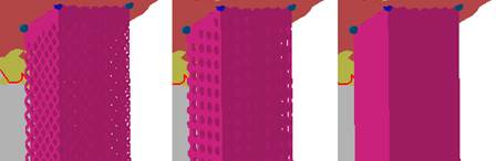

| Structure pattern |
Switch between Wired wall (left), a Punched plate (middle), and Plain (right) to determine the wall pattern of volume supports.
| Width and Height |
Width and height of the hole shapes. |

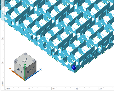

Raster
The raster is built up from intersecting polyline walls and fills the actual volume of volume support.
| Rotate by Z |
Sets the general alignment of filling structures. Filling structures are aligned globally, as in, against the platform coordinates. |
| Hatch distance |
Sets the distance between the inner structure units. The number of inner structure units and the density will be affected.
Note: Not applicable to/available for
Closed-volume-type filling.
| Filling strategy |
Defines in which directions the outer contours of the volume supports will be filled: In both X and Y direction, just in Y, or no filling at all. Notes
| Distance to Contour |
To enforce a distance between the internal volume support entities and the enveloping polyline, set this beyond zero. If it is zero, the raster's walls terminate directly at the contour. Note: This is always measured from the innermost contour, in particular if you have set
Contour count (see below) to values beyond 1.

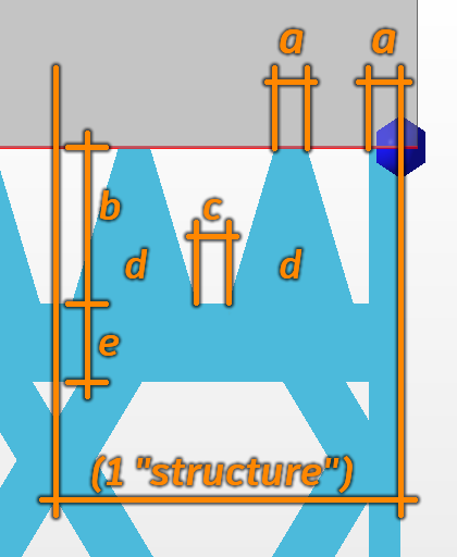

Connection
This group defines the connection between supports, part, and platform floor. It is divided into multiple sub-groups.
| (Connections) | |||
| Top part |
Refers to supports terminating in part surface at its top end. |
| Bottom part |
Refers to supports terminating in part surface at its bottom end. |
| Platform |
Refers to supports terminating in the platform surface at its bottom end. |
| Connection in Y |
This switch, when set to Yes, provides settings to specify a different type of support connections for those polylines that are aligned more towards the perpendicular of the Y axis rather than the perpendicular of the X axis. ![]() In this example, the volume-filling lines have a strip connection in one direction and pin connections in the other direction. |
| Connection by layer |
Clones the surface of the connection area, hugging its contours. See separate table on the parameters below. |
| Connection property | |||
| (Connection) |
Type of connection |
Select from: Strip, Trapoid, Breaking Points, Triangles.
| Connection width | a |
![]() Connection properties |
The width of the vertical strip on the far right can be overridden. See . |
| Connection height | b |
| Pin distance | c |
| Pins per structure | d |
| Distance connection to structure | e |

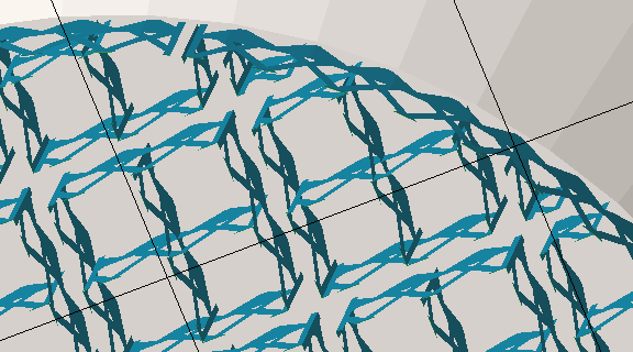

| Interface plate | |
| Use interface plate |
Toggles whether to use this type of connection. |
| Resolution |
If it is not possible to take a copy of the connection surface, a clone is generated through triangulation of anchor points. The higher this value, the higher the accuracy of the triangulation but also the higher the triangle count. |
| Thickness |
Defines the thickness of the interface plate. |
| Distance to structure |
Sets the distance between the interface plate and the support volume. Usually set to 0 but special cases benefit from an intentional detachment. |
| Pin type |
The actual connection between the part and the layer is usually done with pins. Set the type of pins here by choosing from Cross or Cube. Alternatively, disable the pins entirely and connect the interface plate fully to the part. This effectively extrudes the supported cluster in -Z but keeps the distinction of part volume vs. closed volume support. |
| Pin width |
Determines the width of a pin. |
| Pin density |
Determines the density of the pin structure. The smaller the value, the more pins will be created. |

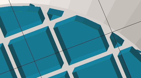

Fragments
Fragmentation of volume supports into individual blocks makes it easier to break the supports from the part.
| Raster |
Turn fragmentation on or off. |
| Fragment size X |
Fragment size in X direction |
| Fragment size Y |
Fragment size in Y direction |
| Fragment gap |
Sets the gap width between volume-filling fragments |
| X and Y shrinkage |
Shrinks the fragment at the bottom end, to have a wider fragment at top, whose size decreases to the set value |
| Offset in X and Y |
Sets a distance by which to displace the raster-fragmenting gaps against the filling. Can also be negative. |
| Contour |
The cluster-enveloping contour can be fragmented as well, using this toggle. |
| Fragment contour length |
Defines the length of a fragment unit |
| Fragment contour gap |
Defines the gap width between two envelope polyline fragments |
| Fragments |
Toggle whether the gaps in the enveloping contours should be aligned with the gaps that the fragments themselves have. |
