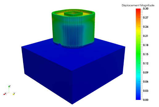

Results can be imported and viewed in the Simulation Utility for Netfabb or in ParaView. Figure 2 shows the computed final distortion before the part is removed from the substrate.
Figure 2 Final distortion results

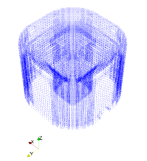

Two point cloud files are produced during the mechanical simulation: 03_mechanical_1.wrtu and 03_mechanical_2.wrtu, which are from the increments right before and after removal of the part from the build plate, respectively, for the nodes of the built component. These files have the format X, Y, Z, X displacement, Y displacement, Z displacement with all the units in mm. A visualization of the X,Y,Z point cloud is shown in Figure 3.
Figure 3: Point cloud file visualization
