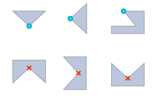

Definition of "edge" in the context of this support action
- non-flat junction between two triangles
- convex on the outside (diverging normal vectors)
- angle between adjacent normals of 40° and more
- visible in orthogonal -Z projection, ignoring self-occlusion
Part sections seen from the side. The top row shows edges supportable with this action, the bottom row shows edges ignored by it. Not shown: Angle minimum of 40° between normals of triangles along a qualifying edge.
