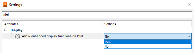

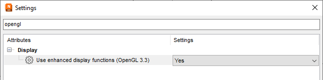

"Netfabb tells me, 'You do not use enhanced display functions.'!" "I have no transparency available in Netfabb!" |
Netfabb needs full OpenGL® 3.3 support. Implementations by Intel® or other manufacturers are reported to sometimes be incompatible or incomplete on occasion. Solution:
For more information, visit How to configure Autodesk software to use high performance graphics. |

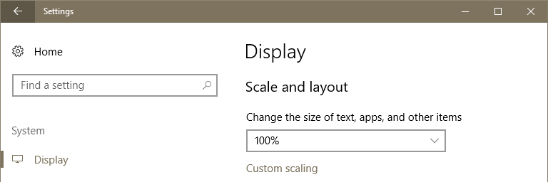

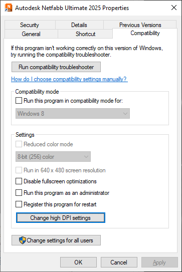

"My display text is too large!" "Window elements are missing or obstructed by the task bar!" |
You may have Netfabb configured to determine the font size automatically while you have Microsoft® Windows® configured to scale text beyond 100 % which can confuse Netfabb's font scaling. Solution:
