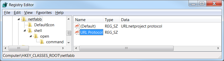

Netfabb Protocol Handler
The Netfabb Protocol Handler is a project and an executable available upon request in conjunction with a licensed add-on privilege. The protocol must be registered manually by making modifications to the Windows Registry:
- In HKEY_CLASSES_ROOT, create a new key named
netfabb. Add to this key:
- New String Value:
- Name: URL Protocol
- Data: (leave empty)
- New Key:
shell
- New Key:
open
- New Key: command
- Existing Value:
(Default)
- Data: "path/to/netfabbProtocolHandler.exe" "%1"
- New Key:
open
- New String Value:
Furthermore, remote control needs to be allowed in the Settings .
Netfabb must be running for the URL calls to work.
