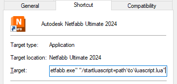

  1. Navigate to the installation folder of Netfabb, typically C:\Program Files\Autodesk\Netfabb Ultimate 2024\.
  2. Find the netfabb.exe executable and create a shortcut to it.
  3. Edit the shortcut and add "/startluascript=path\to\luascript.lua" to what is already specified in the Target: field, adjusted for your Lua script file's respective path and name.
  4. Click Apply.
With a shortcut provisioned like this, you can have Netfabb load a Lua script right at launch.
Note: You cannot provide start parameters for the script itself similar to how you would call the Lua interpreter with the script name and start parameters for that script. Instead, you will have to use different means to communicate the startup parameters, such as by writing a file, for example. For a working example for this visit this response in the Netfabb forum.
