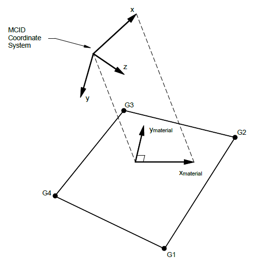

Figure 1: MCID coordinate system definition

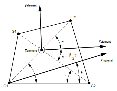

Figure 2: CQUADR element geometry and coordinate system

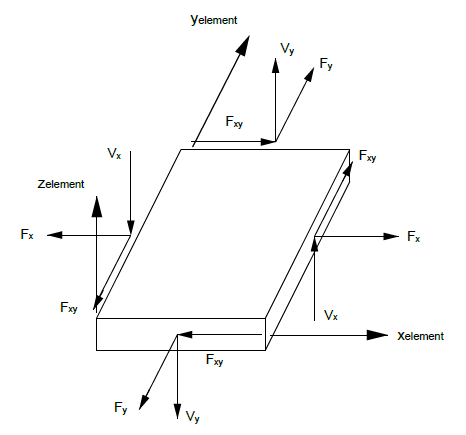

Figure 3a: Forces in CQUADR elements

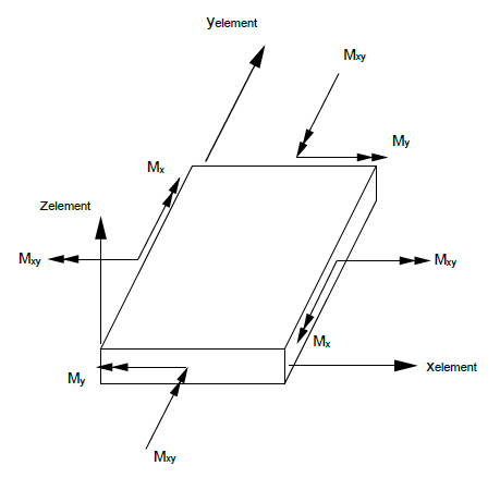

Figure 3b: Moments in CQUADR elements

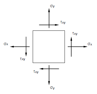

Figure 4: Stresses in CQUADR elements
