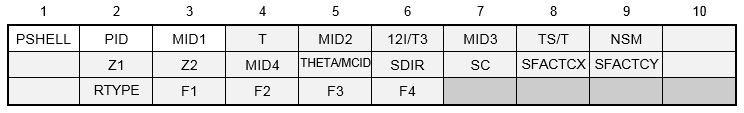

Shell Element Property
Description: Defines the membrane, bending, and transverse shear properties of shell elements (CTRIA3, CTRIAR, CQUAD4, and CQUADR entries).
Format:
